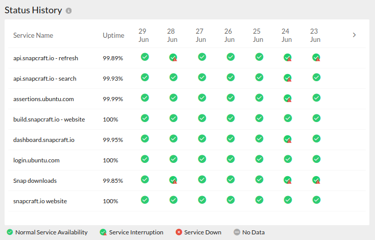

When a snap is installed, it’s downloaded and authenticated against one or more servers attached to the Snap Store (or a local proxy). If a server is unavailable, or suffering bandwidth issues, installation progress will be slow.
You can check on the operational status of the servers attached to the Snap Store from the Snap Store status page: https://status.snapcraft.io/.
Snap Store status
The Snap Store Status page also includes a status history for the servers over the last week and an incident history.
